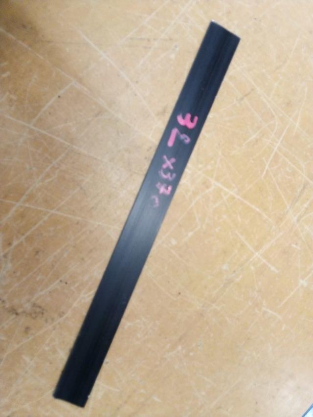

effixe
Joined: 15 Sep 2015
Posts: 795
nord
PostPosted: Thu 18 Jun 2020, 07:49    Post subject: recherche pieces viva ACX2 Reply with quote
J'ai ceci en cerclage 32x370mm mais ep 0.8
