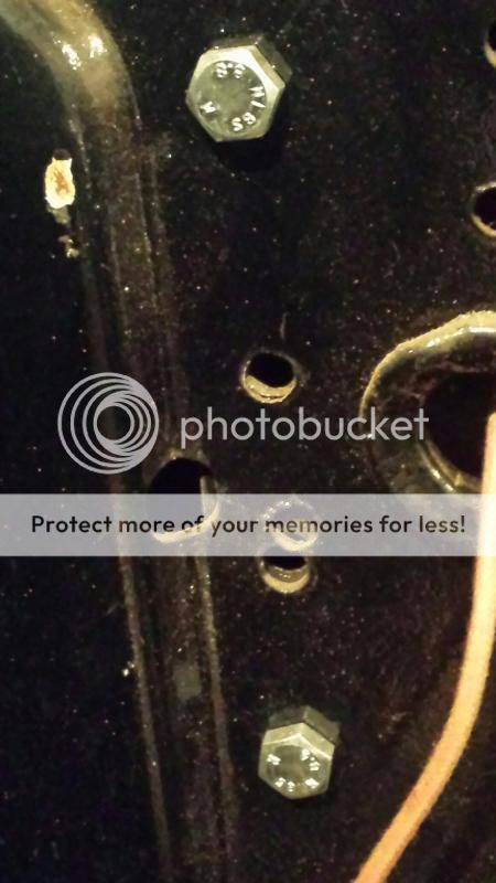

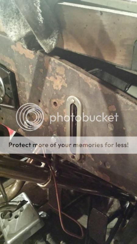

Hopefully these will tell the story...
There should be a lever in this slot which attaches to the bulkhead
Then something comes out here into the engine bay, behind the radiator and goes down toward the chassis
