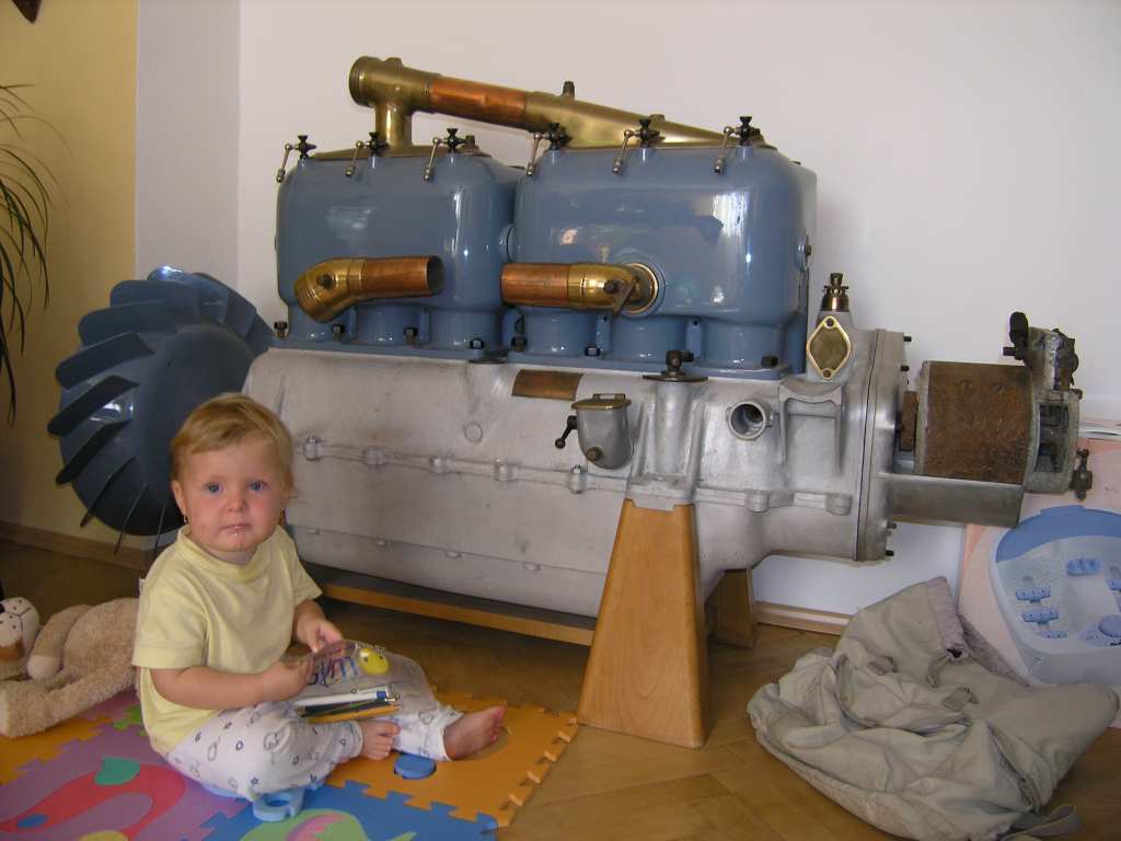

So, the car is in the same state now, how I bought it. Photos for You, will be taken up in the workshop (The engine I have display in my living-room, of course You would like to see the pictures of the comlete car, not just parts).

Hello,
I have some more information about the car.
The wheelbase is 399 cm. The engine has bore /stroke 110x160mm and has dynastart of course. From informations which I have it can be type HF or IR and year 1920 or 1921, but I am not sure.
I will try to get there some pictures of the frame number and engine.
Thank You

Whaouuuu...!... Shocked
Hello Boy, don't be afraid, it's just an engine of the RENAULT production...!
The original...!!!

Hello, Paul,
At the moment, I can only confirm your analysis : your car must be from HF or IR type, due mainly to : wheelbase 399 cm, bore 110 mm, no brake at the front wheels. Actually, I believe differences between these 2 types are very few. But the numbers stamped at the front of the frame should allow us to decide which type it is, based on Renault records.
We'll see.
PS : thank you for the pictures, and welcome to the young engine lover Okay

Ouf, c'est bien une 40... Okay

Shocked  J'avais déjà vu une moto dans un salon, mais ça Bravo
